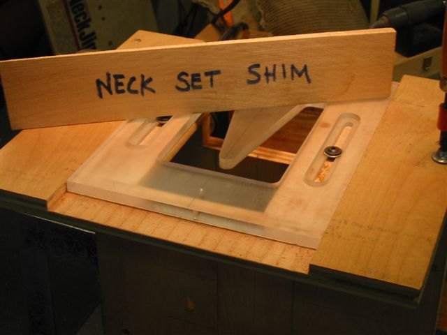

no kidding,
I really do use this, it is a perfect 1 1/2* back set.
I have them available in the color of your choice for only $49.99 + shipping and handling.
Order yours today!

Well thought-out jig there Matt. Looks like you put a lot of work into it.
PostPosted: Mon Jul 17, 2006 1:19 am
Matt, do you use a dovetail or straight mortise joint? So, instead of shaping the heel, you just put the wedge into the pocket?
I'm sorry if my questions sound inane, I'm just trying to visualize how you get tight joint at the heel using a shim.

Joe, I may be wrong but I think Matt is using the wedge to adjust the body/neck angle buy putting it between neck and the jig while he makes the cut.

Shim should work fine, assuming everything you build will be dead-square from here on....
Better measure before you cut the next dozen, though. Variations, happen.

Genius, Matt! You'll sell cords of those things!
Seriously, though, could you give us a photo of this gem in action? How's it all come together with the neck clamped to the jig?

can we see it in action?!?

well I dont have time right now for a pictorial.
but yes I do use dovetails and the shingle goes under the neck when it is clamped in the tenon jig. you can adjust the back set simply by sliding the shim up or down. i use a protractor to check the set angle before i cut...so dont be so horrified!
